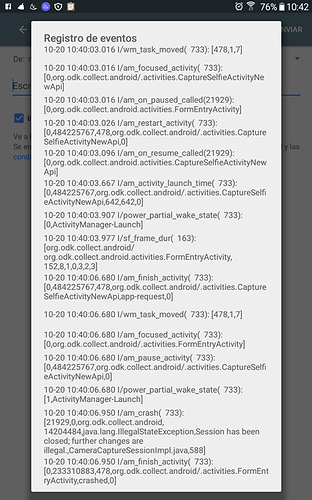

Using the Selfie appearance (Image type question) crashes ODK Collect.
This happens when pressing the touchscreen to take the photo/selfie. The device lags for a few seconds and then it crashes.
This happened while testing a form with a few devices of different companies (Samsung, Huawei, etc.). I double checked that all had a front camera. About 6 of 15 devices had this problem.

In at least 2 devices, opening ODK Collect after the crash would fix the problem. This wasn't the case for the other 4.
Anything else we should know or have? If you have a test form or screenshots or logs, attach here.
