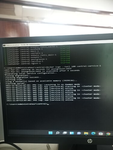

I just installed central everything worked well. Central started well, see screenshot below. Except that the browser tells me that the site is not accessible. I don't understand.

Hello everyone.

Additional information I installed central locally on windows
What do your service and nginx container logs say?
