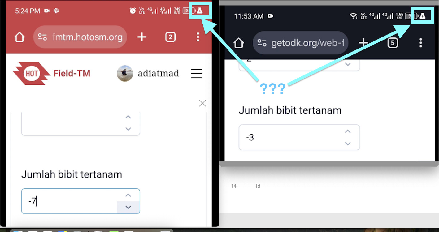

I managed to get the user to test on Web Forms Preview, so it's unrelated to our code wrapper:
They reported the same behaviour on the original device (Android 13, chrome 138.0.7204.169):
I don't want to lose the goodwill of the user by pestering them too much :smile: But if there is anything else (that isn't too technical / debugging) I could ask them, then please let me know :folded_hands:

@spwoodcock thanks for testing and sending that video.
I noticed the flask icon in both videos from the user. Could Developer Mode be enabled, or are any experimental features active? Could the device be managed through MDM? I'm also wondering if any system configuration could be influencing this. Just exploring all possible causes :thinking:
Good observation!
I would think it highly unlikely for developer options being enabled on their device, but perhaps they have MDM.
I will check with them & get back to you :grinning_face_with_smiling_eyes:
