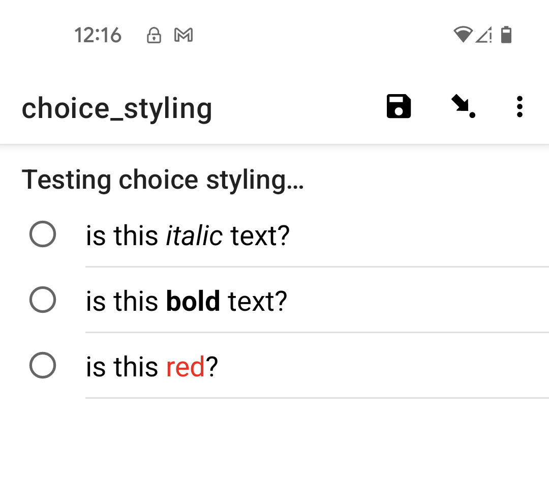

Styling should work on choices - although just in Collect, not in Enketo.
| list name | name |                    label                    |
| options   | a    | is this _italic_ text?                      |
| options   | b    | is this **bold** text?                      |
| options   | c    | is this <span style="color:red">red</span>? |

Unfortunately, if that's the case then I am guessing it is a bug in the outdated version of Collect.
This works nicely in Collect.
