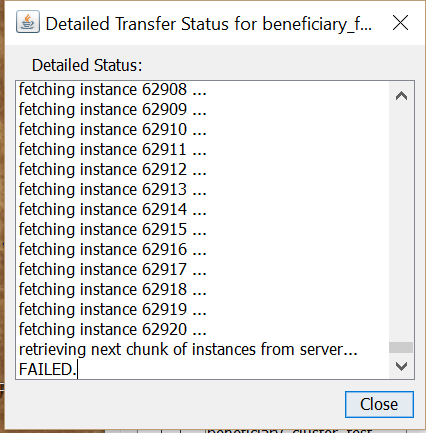

Thanks Mitch. I was running into the hurdle of each time I restarted,
waiting hours for briefcase to resolve already downloaded instances.
I am still facing a 'FAILED' message -- (see attached screenshot). I
mistakenly stated that I was pulling from Google App engine before in this
chain (probably because 95% of the time I am), but for this instance I'm
pulling from a survey deployed on Kobo (I'm cross posting this on the Kobo
forum as well). Based on the Kobo dashboard I know the deployment only has
62,920 instances. Briefcase's status window (before the 'FAILED' notice),
cites it has fetched 62,920 instances.
Even though it has a 'Failed' notice, I have tried to export, but get a
second error message resulting from an expected .jpg that isn't found --
allowing me to export less than 200 cases.
Any insights, tips, thoughts, to obtain this data would be very welcome.
[side note of relevance: I'm unable to download the data directly from
Kobo, I get a perpetual 'pending...click to refresh' message when
attempting to download any format of the data].
~Lloyd

That's a question for Kobo.
ODK Aggregate will not make a submission available for download until it
has all of its image attachments or until you edit the submission and
destroy the links to the missing attachments (via the Forms Management /
Submission Admin sub-tab).
Sounds like Kobo does not have that protective step. ODK Briefcase expects
all referenced attachments to be available.
Also sounds like Kobo might not return the responses that ODK Briefcase
expects when there are no more submissions to be downloaded.

Hi Lloyd,
As I wrote on the KoBo thread
https://groups.google.com/forum/#!topic/kobo-users/iArUmvnOGDw,
downloading all instances with Briefcase is not a problem and works just
like in Aggregate (attachments and all). The reason it's taking a long time
is just because of the huge number of attachments, which is slowed down by
AWS serving as the file storage. I just tried resuming a regular project
without any attachments but 10k submissions and it only took a few seconds
to confirm that all instances had already been downloaded.
In short, all good on the Briefcase front.
~Lloyd
