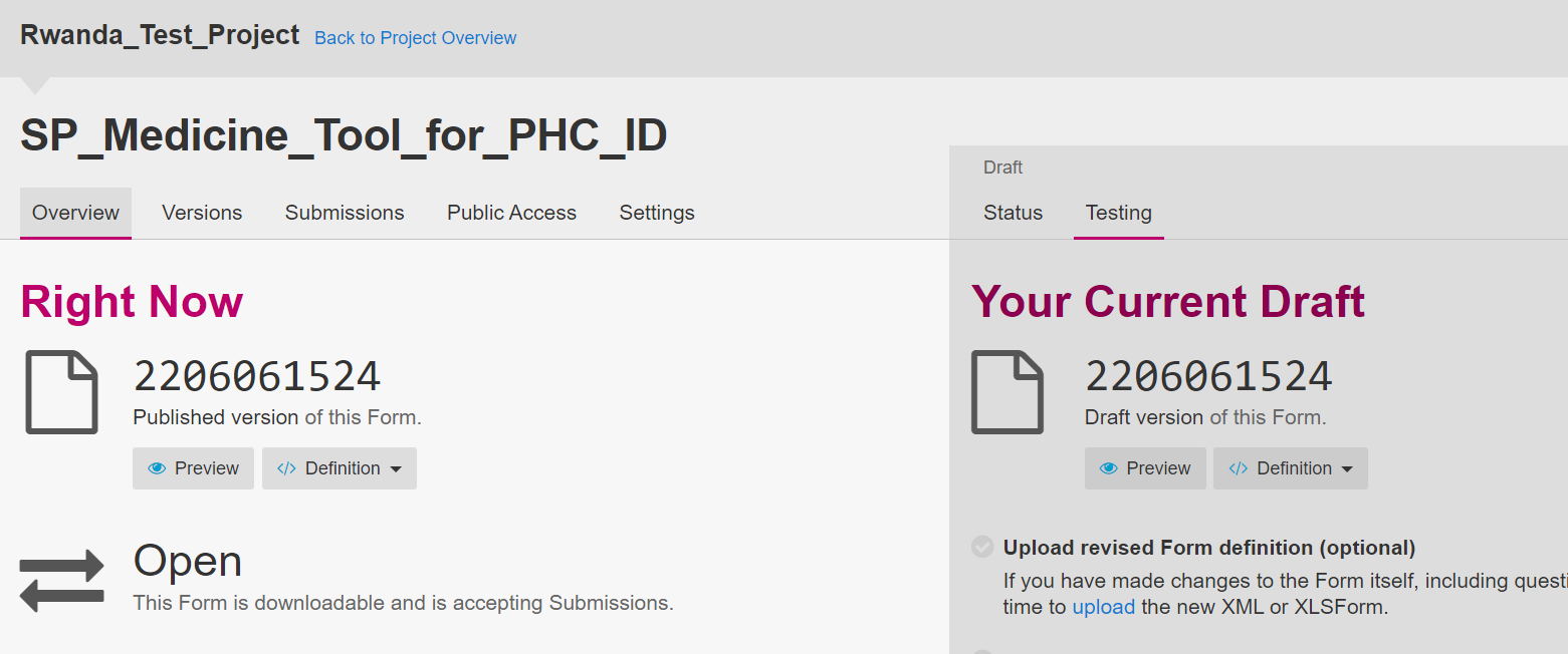

Trying to upload media files in Central but the Media tab is missing
I uploaded a survey form in Central. I see the Status and Testing tabs off to the right. There is usually a Media tab in the middle of those two tabs. I need to upload a few preloads but the Media tab is missing.
To be clear, another survey I have does show this media tab and I am able to upload to that survey. I am not sure what is different.
This is a good question. Screen shot is attached.

Can you please share either your full form or the row that declares the media file you expect to upload? If there’s no media tab, that means Central does not see any media required by the form definition.
Thank you so much for the response LN!
I have the same code in two different surveys and one seems to recognize that there is media and the other does not.
I am attaching the file here. It is row 4 in the Excel that has the first search term for a preload.

Good morning @Rita_Cuckovich,
Unfortunately, you forgot an "a" in the name of the appearance column of your survey sheet. Since you are allowed to add any column you want to your xlsform, you will not be notified of the "error".
