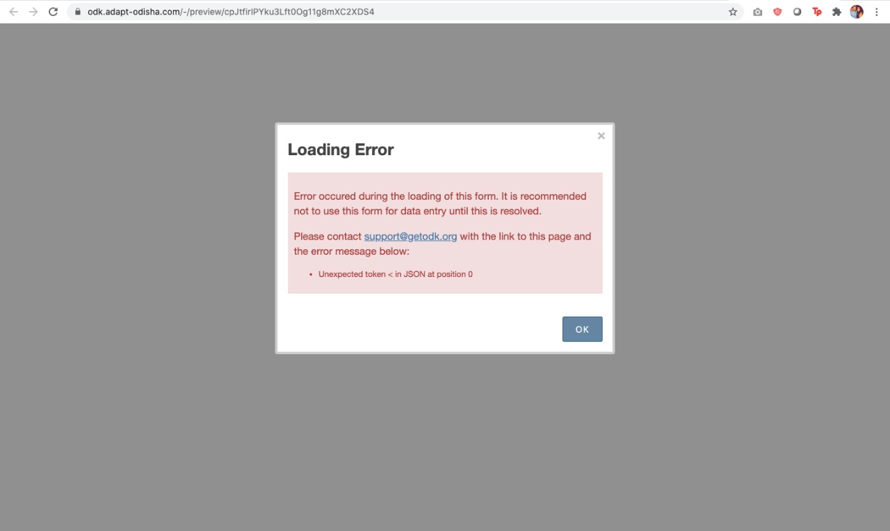

Hey @LN, we've recently setup ODK Central. While ODK forms are working fine on a mobile app, web-forms through Enketo are not working. Attaching the form and sharing a screenshot of the error. Any solution around this?
Thanks for this, @Sandeep_Prabhu1! Did you experience this same issue and fix it by making sure your host doesn't have a firewall? Given how small the forms @Chakshu_Gautam and @Aayush_Kedia have shared are, an internal networking issue does seem a lot more likely than a true form transformation issue. Did you both follow the instructions @Sandeep_Prabhu1 references here? Are you on a host other than Digital Ocean that could have some other kind of internal firewall?
