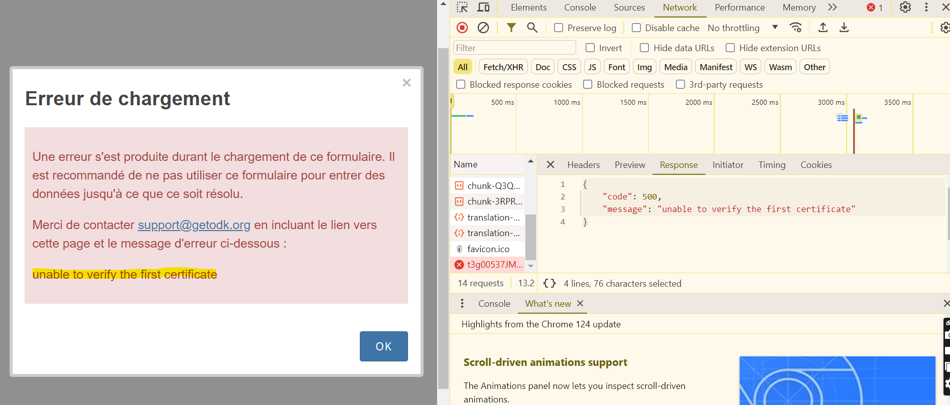

Hi Yanokwa,
We checked whether the certs are properly chained, and below is the error message we got.
Also, please find below the ssl certificate configurations in "odk.conf.template" file for your reference.

We only support the custom ssl configuration in our docs.
It looks like you've made changes to odk.conf.template? My recommendation is revert any changes you've made, make sure fullchain.pem file which contains your cert followed by any necessary intermediate certs (e.g, DigiCertCA), delete the nginx container and rebuild.
If you wish to keep your changes, then we're limited in the support we can provide. Look through https://github.com/getodk/central/tree/master/files/nginx and https://github.com/JonasAlfredsson/docker-nginx-certbot for what might be going wrong.
