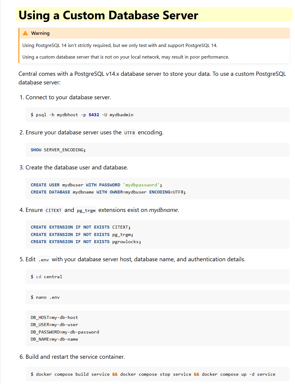

@yanokwa, I followed all steps in this section:
from this doc https://docs.getodk.org/central-install-digital-ocean/#using-a-custom-database-server.

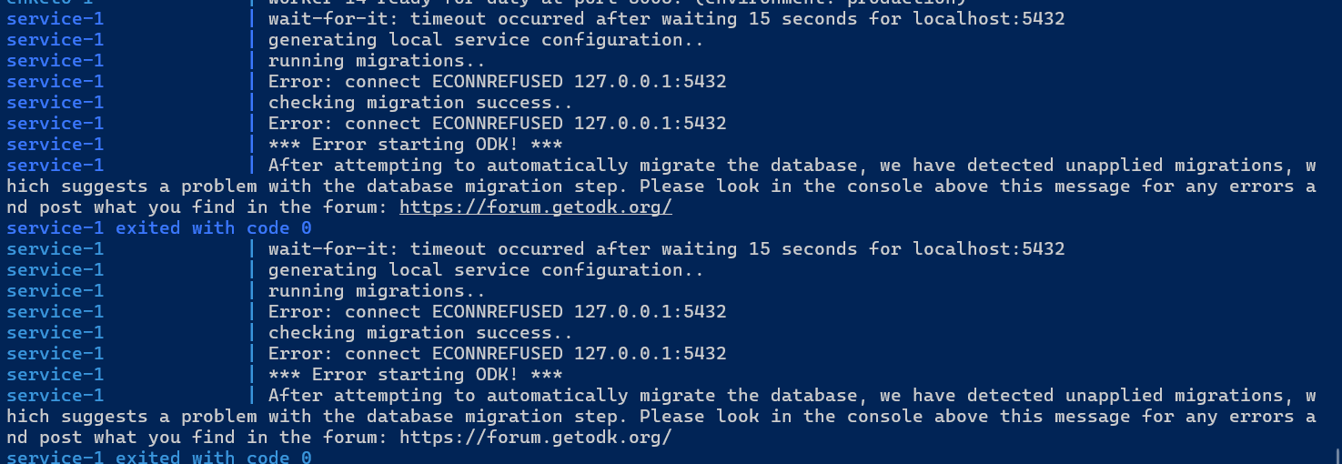

However, when I start my docker compose file, I see this error:

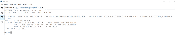

even though I can connect to my external Db
What else do I need to do?

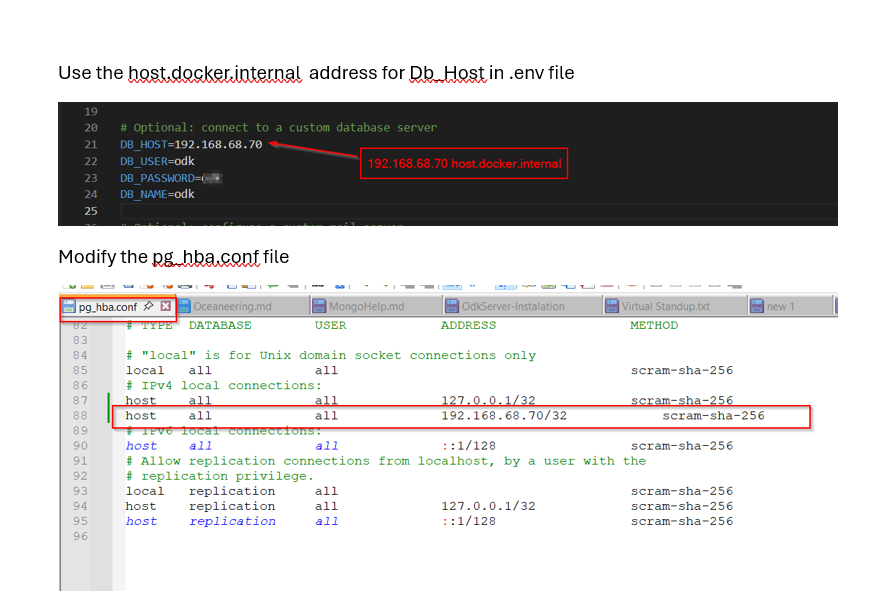

This post help alot. Issues with connecting postgres (localhost) with latest odk central (v 2023.2) - #7 by Arunbala.
and here is the details about the solution:
