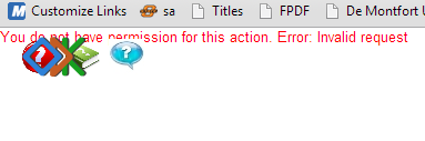

This is what i see
https://lh4.googleusercontent.com/-Wkzh2N4ChRE/UkqQIkCXPiI/AAAAAAAAEMM/G4aVBi4FYfs/s1600/Capture.PNG
··· On Tuesday, 1 October 2013 10:49:49 UTC+3, Tony Kazungu wrote: > > Hi Tumaini, > Did you get to solve this issue, I am doing a local install of aggregate > Tomcat 7.0/Postgresql/Java 7. I cannot get to the login screen all i see > when i load the aggregate page is a logo of ODK and help icons. > > Here is something from my logs which i think could be the issue but I > don't see how i can go about it. > > SEVERE: The web application [/ODKAggregate] registered the JDBC driver > [org.postgresql.Driver] but failed to unregister it when the web > application was stopped. To prevent a memory leak, the JDBC Driver has been > forcibly unregistered. > > > On Wednesday, 30 November 2011 10:59:10 UTC+3, Tumaini Kilimba wrote: >> >> Dear Sirs et Madames, >> I recently installed ODK Aggregate along with postgresql and Tomcat 6, >> everything was rosy. Am now wanting to scale up the testing so installed >> Aggregate on a server running Tomcat 7 and postgresql - not so rosy. When I >> navigate to the ODK Aggregate instance on a browser, the login page >> displays fine. I log in with Google id, it lets me in (kind of) but the >> screen has very little other than some icons and the words "You do not have >> permission for this action. Error: Invalid request". I read a post here >> which seemed to suggest that I need to go Tomcats server.xml file and set >> the copyXML attribute of the element to "true" ( >> http://code.google.com/p/opendatakit/issues/detail?id=420), which I did >> but the error still persists. Am attaching the contents of the >> catalina.2011-11-30.log file, hoping it may be useful for someone here to >> let me know what may be happening? >> >> Thanks in advance, >> Tumaini >> >

This is what i see

Hi Tumaini,
