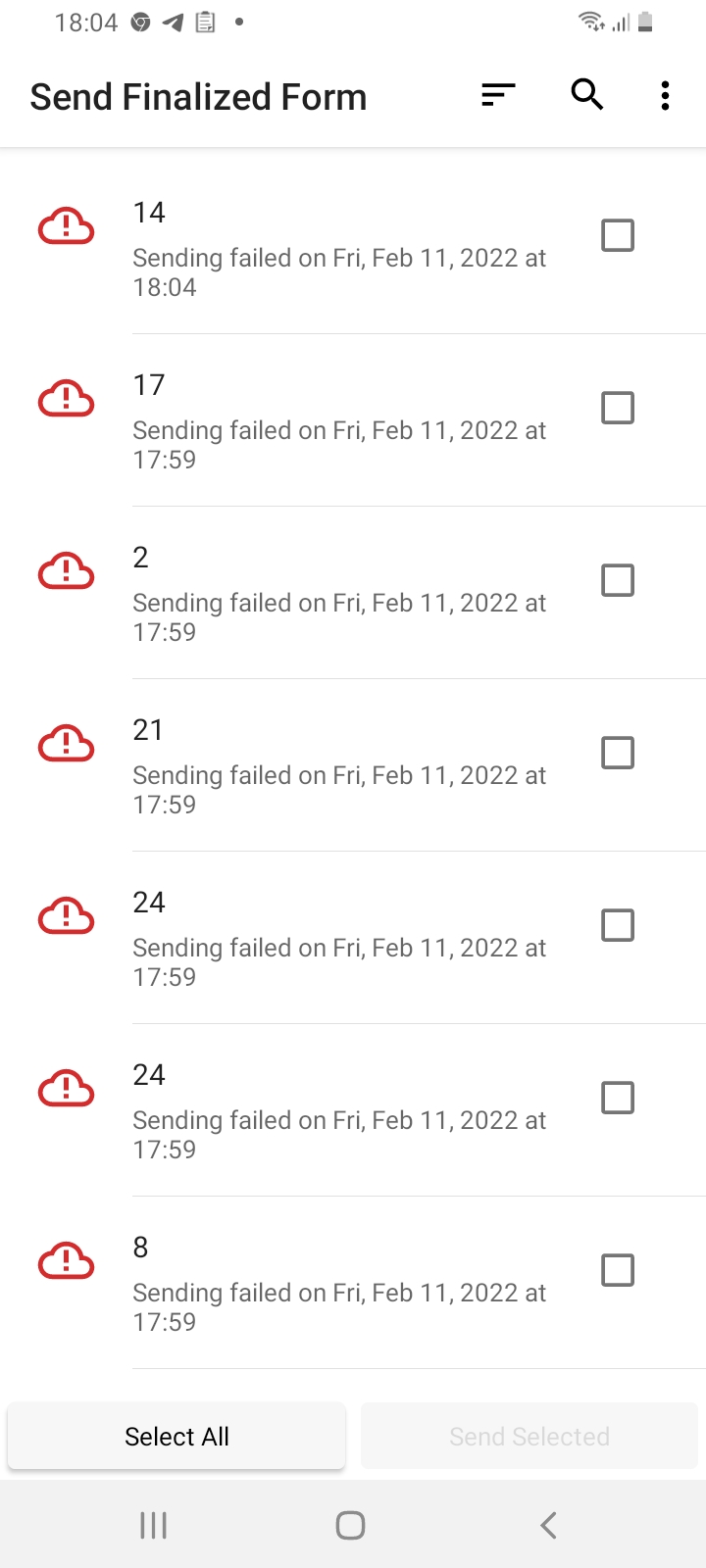

I tested the draft version of my form on my mobile device afyer which i published the form. While my other app users had the published formand could send their forms after data collection, i could npt and only realised mine was still the draft form.
I am getting "Eror:generic exception. Could not find the resource you are looking for ".

Maybe I am wrong but I think you are still using the test form on you Collect app. As you publish your form, the test instance does not exist anymore and you need to connect to the project hosting the form and fill the form from here.
Thank you for your response.
Yes i realised same. I thought i read the form will be updated once published but i was wrong.
Does it mean there is no way to access the data again?
If you used a draft of the version that you ended up publishing, you can go to settings (from the landing screen, tap on the project icon at the top right, then Settings) and then at the bottom tap on Project management, Reconfigure with QR code, and scan an App User code that has access to your published form. That should allow you to send those submissions. If not, please share what error message you're getting.
