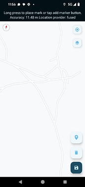

I created an mbtiles layer from satellite imagery and successfully loaded it to Collect. However, the file only contains a single zoom level of files (in this case z15). When viewed it Collect it toggle off when the user has zoomed outside of level 15.
For example...
zoomed out // zoom level 15 // zoomed in more
Is there a way to get Collect to still render the mbtiles images at higher zoom levels? That is, if I wanted the z15 tiles to still be displayed at z16 and above without having to explode the mbtiles file size by saving the tiles for those additional zoom levels into it? Have Collect "overzoom" and enlarge the z15 tiles (with accompanying pixelation)? Perhaps through something like modifying the mbtiles metadata?

FWIW, I discovered that if you change the main map source to Mapbox (instead of Google or OpenStreetMap) it will keep the offline layer visible and overzoom it.
I was about to reply and tell you that different basemaps do different things when you zoom past the highest level in your tileset :wink:
I found this a while back when the mapbox update removed the ability to zoom very very close
