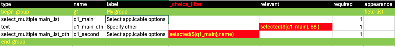

For the OPPO section to show/hide, you should make it a group (as shown in the below screenshot). And then the relevant will work on all of the questions in the group. In the form you shared, the relevant is just showing/ hiding a note.
