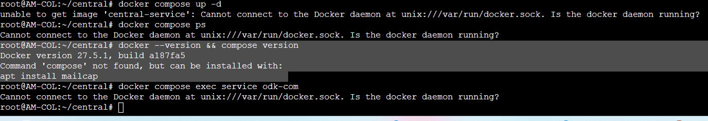

3.2 I also checked the status of my installation with the command docker --version && compose version and found that docker compose seems to have disappeared. See console command output below
root@AM-COL:~/central# docker --version && compose version
Docker version 27.5.1, build a187fa5
Command 'compose' not found, but can be installed with:
apt install mailcap
Docker compose was installed successfully and has been running in the past. ODK Central contains many survey submissions from ODK Collect.
