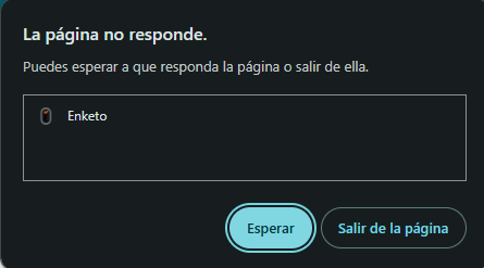

I created a follow up form that uses entities from two different forms and it also uploads images and files to this form. When editing one of them, the loading speed is very slow in Enketo.

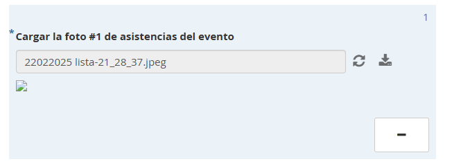

In some cases the forms load but with no visibility of the photos and files

I experience this a lot with forms that have a lot of media reference files, it can lead to the captured media never loading in Enketo when editing a submission as it is trying to load the reference media first.

@EduardoCM Enketo isn't very smart about how it downloads lots of attachments, so on a slow connection it can overwhelm the connection and slow things done.
Web Forms will be smarter (hopefully a lot smarter) about this. Until it's available, @ahblake's workaround is likely your best option.
You can use your browser's inspect mode to help answer that question. When you look at the network tab, you should be able to see how much time is spent by the server processing the request and how much time is spent on the transfer. Changing the server's characteristics will affect the processing part. Changing the server or client's connection type/speed will affect the transfer part.

We managed to solved this problem by using pulldata() instead of instance().
Background:
When Form Definition contains many instance() lookup and the associated secondary instance (entity-list) contains thousands of rows then Enketo needs iterate through the list many times, which takes time. If Enketo is able to complete all the lookups with 30 seconds then user will see the media/images on the Form otherwise they won't. The time taken by Enketo is dependent on the number of rows in the secondary instance, number instance() functions in the Form definition, user's machine, OS and browser as well.
To circumvent this problem, Form definition can be updated to use pulldata() instead of instance(). In Enketo, pulldata uses browsers default xpath evaluator, which is generally faster, see more details at Difference or use of 'pulldata' and 'instance' - #2 by LN
