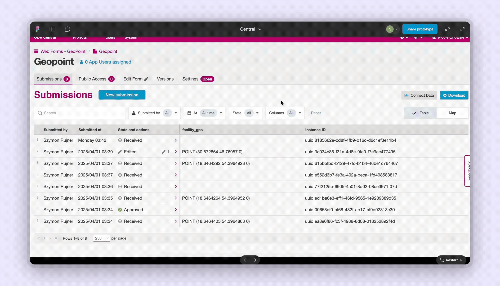

We’re excited to share that we’re starting to design a map view for Submissions and Entities in ODK Central! :tada:
We’ve heard from many of you that mapping is a key part of your workflows—whether you're running vaccination campaigns, bed net distributions, household surveys, or any number of other location-based activities. In all of these cases, seeing data on a map helps make patterns more visible and decision-making more intuitive.
Our goal is to bring more of that spatial insight directly into Central. This new map view will complement the existing table view, giving you a more visual way to explore your data.
For Entity Lists, each Entity will be mapped using the geometry property if it exists. This matches how select_one with the map appearance works.
For Submission Lists, each Submission will be mapped using the first geopoint/trace/shape found in the form definition that is outside of any repeat. This is similar to the submission map in Collect (documentation). If you have a form with locations captured in a repeat, you will soon be able to create Entities from those repeat instances and see them on the Entity List map.
As always, we’ll be sharing updates along the way and will be looking for your feedback. Let us know what you’d like to see in a map view—your input will help shape the direction!

Starting in Central v2025.3, the submission map is now available! :world_map: You can now also find it in the documentation.
The Entities map will be available starting in v2025.4, expected mid-December. If you have any feedback around the mapping experience, please let us know.
For now, the map is intended to be a simple alternative representation of the data table to help with spot checking as data is being captured and basic sense making before a deeper analysis pass. Submissions are mapped according to the first geometry they include only. We may eventually make it possible to combine submissions from different forms, Entities and multiple geometries per form.
