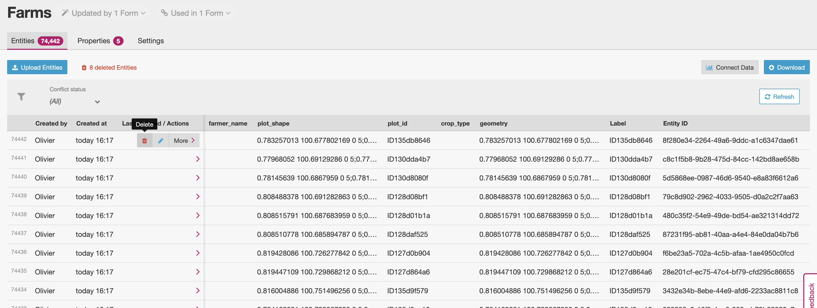

On ODK central, i can only delete entities one by one. I would actually like to delete many more all at once. Is it possible?
Simply upload way to many entities.
I deleted entities one by one... that's too long for 75K
