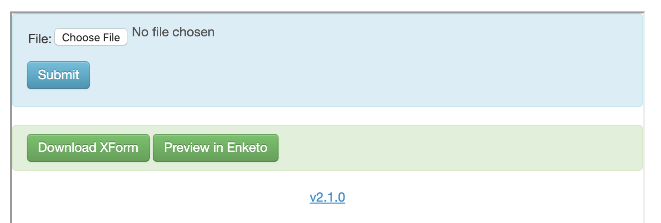

It passes https://opendatakit.org/xlsform/ just fine:
But select_one_from_file.xml (923 Bytes) errors on upload to Aggregate:
