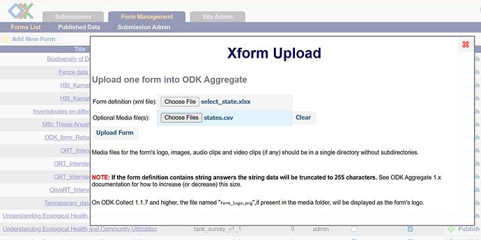

I have created a test xlsform with select_one_from_file states,csv. I have created states.csv with name and label columns too. the form is successfully compiled at https://getodk.org/xlsform/.

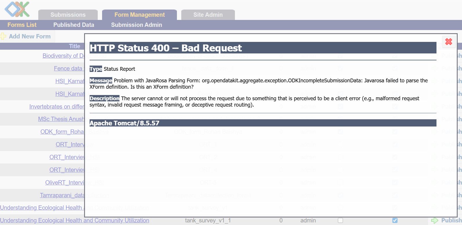

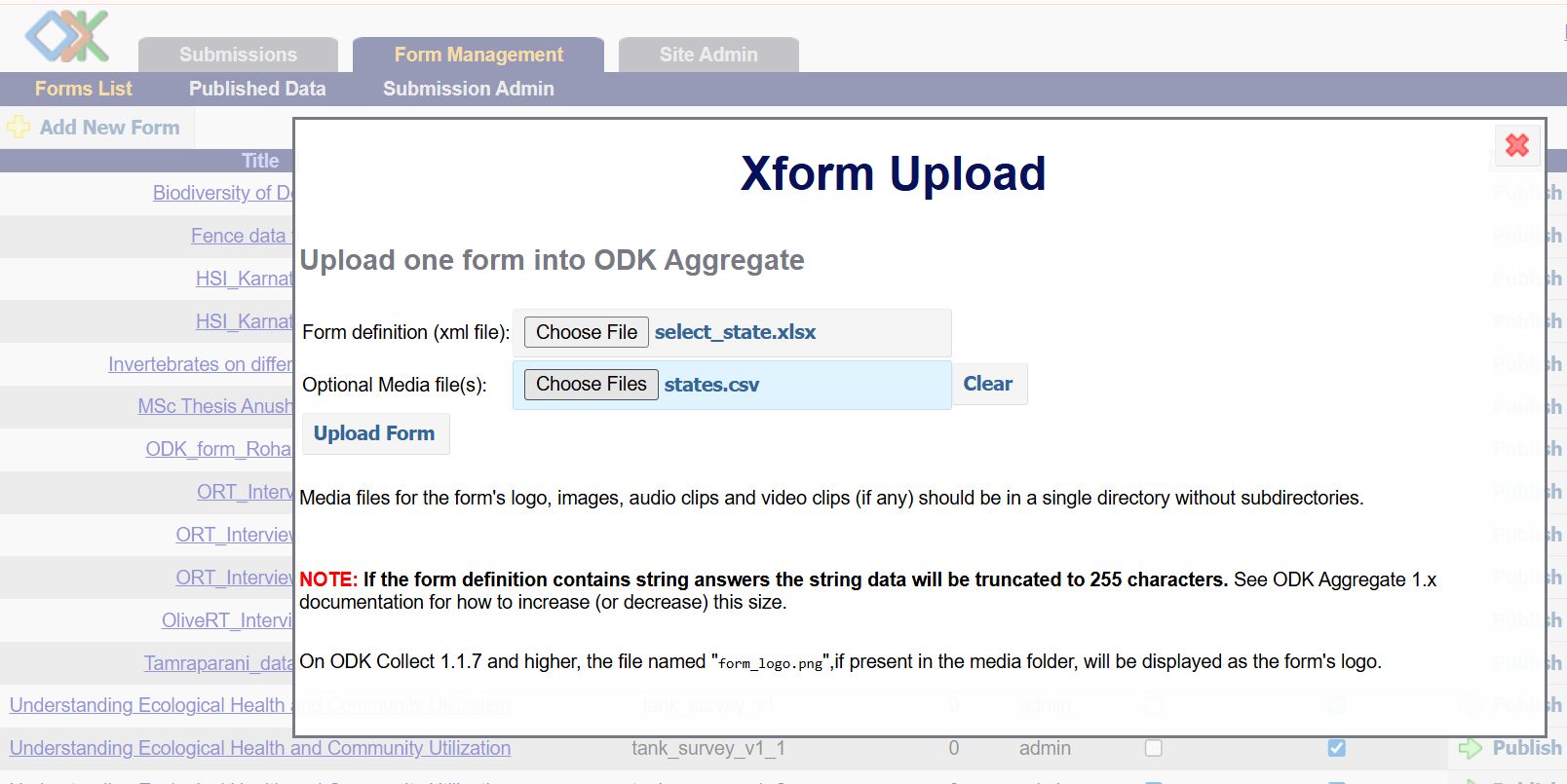

But when i try to upload the form with the csv file as indicated in the screen sheets , it gives the following error.

I'm afraid that select_one_from_file was introduced after aggregate has reached end of life so it can't understand your form definition.
Select_one from csv file support in ODK Collect and Enketo - #3 by LN?
You should consider switching to Central
