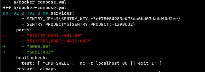

I retained 80 and 443 in .env for the HTTP_PORT and HTTPS_PORT variables, respectively. However, I modified docker-compose.yml to use the non-standard ports I desired.
Here is my only change (generated using git diff):
I hope that helps!

I made a similar change to the docker compose, and now get redirection errors, so I think my problem is now with to reverse proxy configuration. I'll have to read more about that.
So from what I can make out, the docker compose file is not using the .env configuration for nginx container.
Now in nginx container, the internal ports 80 has been mapped to host port 5050 and nginx internal port 443 has been mapped to the host port 5051.
This means I will need to proxy pass traffic from the upstream reverse proxy port 443 to the docker host up port 5050. I hope my reading is correct
