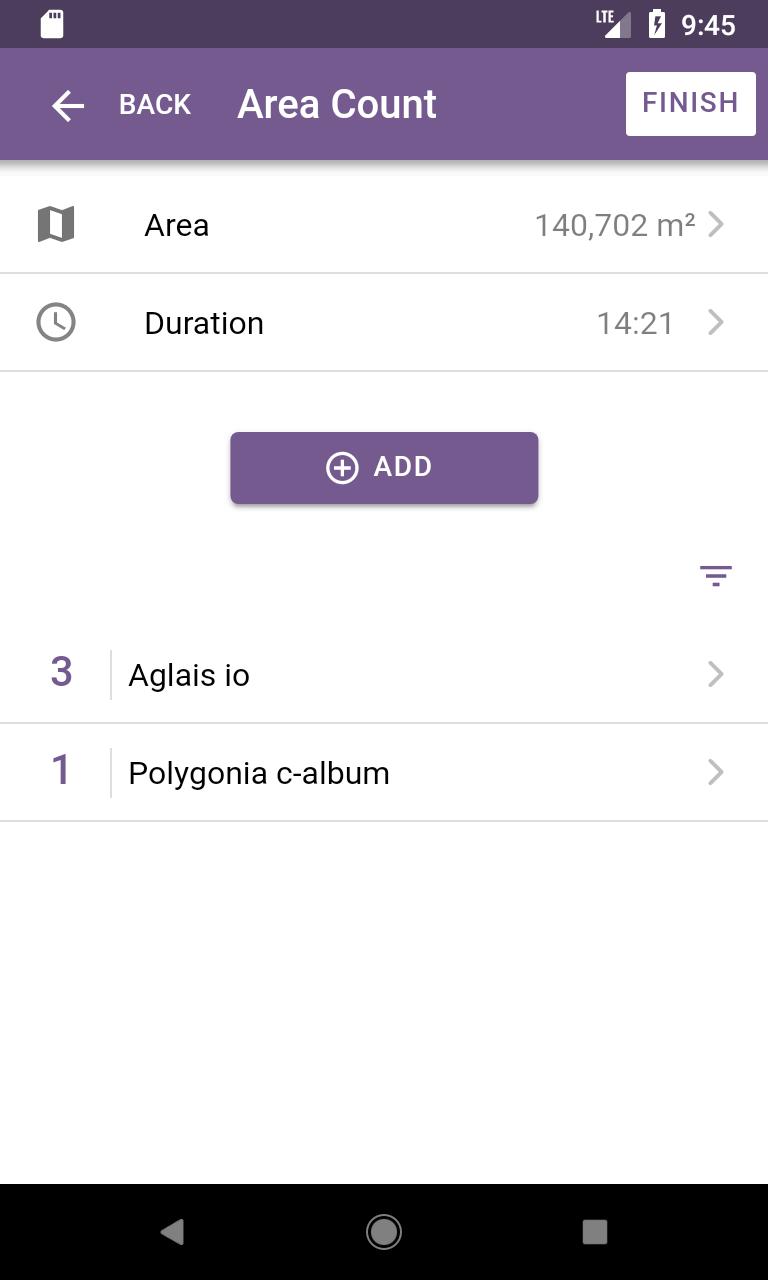

I try to base a part of my form on the model of an existing application. In a first, time the aim is to allow to select on a main page various answers (that are butterfly species precisely) wich are diplayed next as a list of answers in an other question. I succeed in this goal. My problem comes after. When I select an answer (a species) I would like that open a page with details to be filled in and then saved. the aim here is to associate to each answer (species) a details page on wich it's possible then to return to by reselcting the answer (the same species) later without the previous registred details being reset to be able to update them. Also, when these details are filled in, you should be able to easily return to the main page.
I don't know if it's possible to making such an interface with ODK. Do you have any ideas for me that come to mind?
I think it's possible to do that with conditionnally showing questions but it's implies to create a group of questions for each species but for 208 species, it will be very long to make. Also, that implies to have many colums in the results table. I would like if possible to regroup results in a single table with differents lines.
Thank you for your answers.
This is the interface of the application I'm trying to reproduce :

A short answer : it is not possible to achieve what you want with ODK (clicking an option and opening a page). Even if you manage to create 208 groups of questions (one per species), you'll still need a repeat to choose the species and if it has already be observed, you will not reopen the previous answers...
Generally we want to add one or more individuals to a given species. This can be done after the field, one the database side. For the moment the solution we offer to our colleagues is to loop into the species select_one list and add a new observation for each contact. In the end we compute the data to get the total in the database. Looking at your form, I think it is the only field you want to update if a species is sax several times on the field.
We can also print a summary at the end of the form/loop to help user to see if he forgot a species.
But, if you want to get only one repeat instance per species (and update values manually) and you create your form that way, you can name your repeats to help users to navigate into the form.

Thanks but as for yours, you'll have to manage already selected species :
  • hiding it from the choice list
  • or prompt an note
to encourage users to navigate to the previous obs of the wanted species... It is easily feasible but not so intuitive for general public.
For me, the more intuitive is to add an entry for every observation and compute a summary but it must be tested with real users.

However, in use, it isn't very convenient on the field. An interface like I tried to make would be more useful. Or at least, a way to browse through repeat instances easier than it is curently provided, by clicking on elements of a created list would be more intuitive for users.
