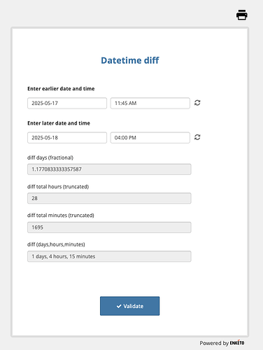

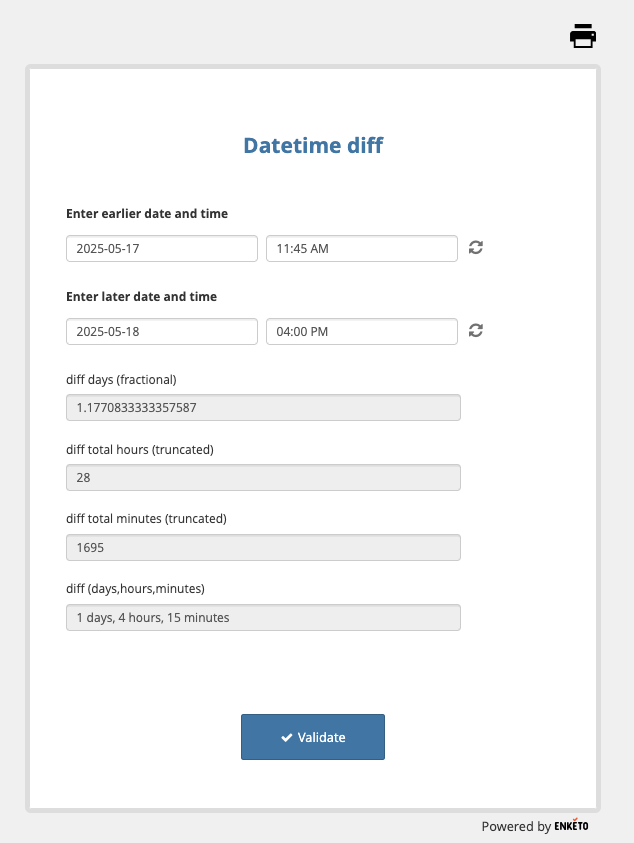

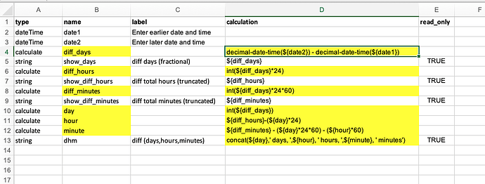

Rows 22-37 have calculations that were WAY more complex than I would have originally thought but basically calculates the number of hours and minutes between two datetime questions.
