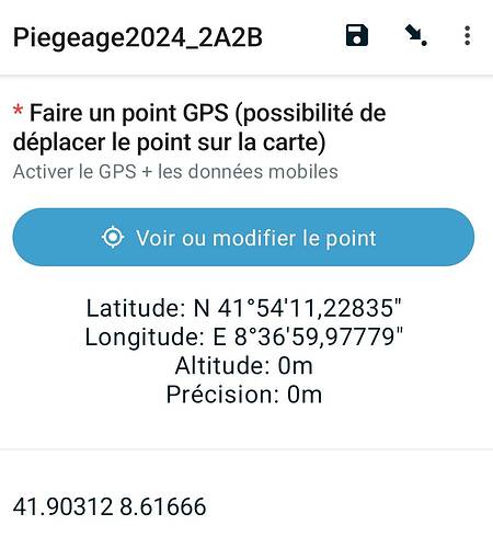

As a workaround you can use a calculation and show it in a note :
Geopoint is a "Space-separated list of valid latitude (decimal degrees), longitude (decimal degrees), altitude (decimal meters) and accuracy (decimal meters)"
You can use selected-at(${question}, index) function to get any part of the list.
type name label hint calculation
geopoint point_gps Localisation
calculate coordonnees concat(selected-at(${point_gps},1),’ ; ‘,selected-at(${point_gps},0))
note affichage_coord Coordonnées ${coordonnees}
As a quick hack, you can see decimal degrees in the navigation view which you can access through the arrow at the top right edge.

It's a good idea, I just try it, it works for me.
Thanks Mathieu
Below is my xml example
Test.xml (1.4 KB)
Thanks Florian, Yanokwa for answering.
I had seen when drop-down the questions of the form the format DD.DDDDD° appeared, however it is not very practical, but it helps. Like this format already exists in ODK Collect, it may be easy to show it, that's why i posted. Mathieu brings a solution.

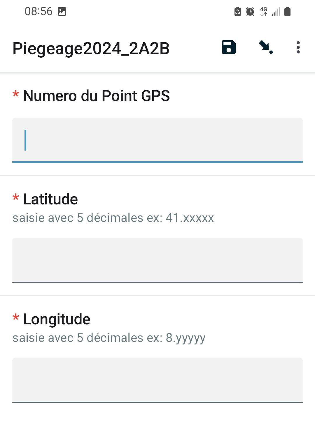

To explain the example of my structure:
When taking coordinates,
I offer two choices,
the phone widget
OR
enter the data manually because we have a Garmin GPSMAP 64S GPS in parallel in case the phone does not pick up well enough, because we need to have 4G to locate ourselves well, the GPS sensor alone of our smartphones is not as precise. When we find ourselves in a rural area, we sometimes use the Garmin GPS to be more precise.
CHOICE
CASE WIDGET GPS
CASE MANUEL ENTRY
The simplest manual input is decimal.
And this is the default configuration of our tools to display WGS84.
The solution proposed by Mathieu solved this problem, I have the dual display.
And I think it's now the more common way to read or input coordinates in most common GPS devices or GIS tools.
People con note their coordinates if they want on a paper and use it later out of odk.
